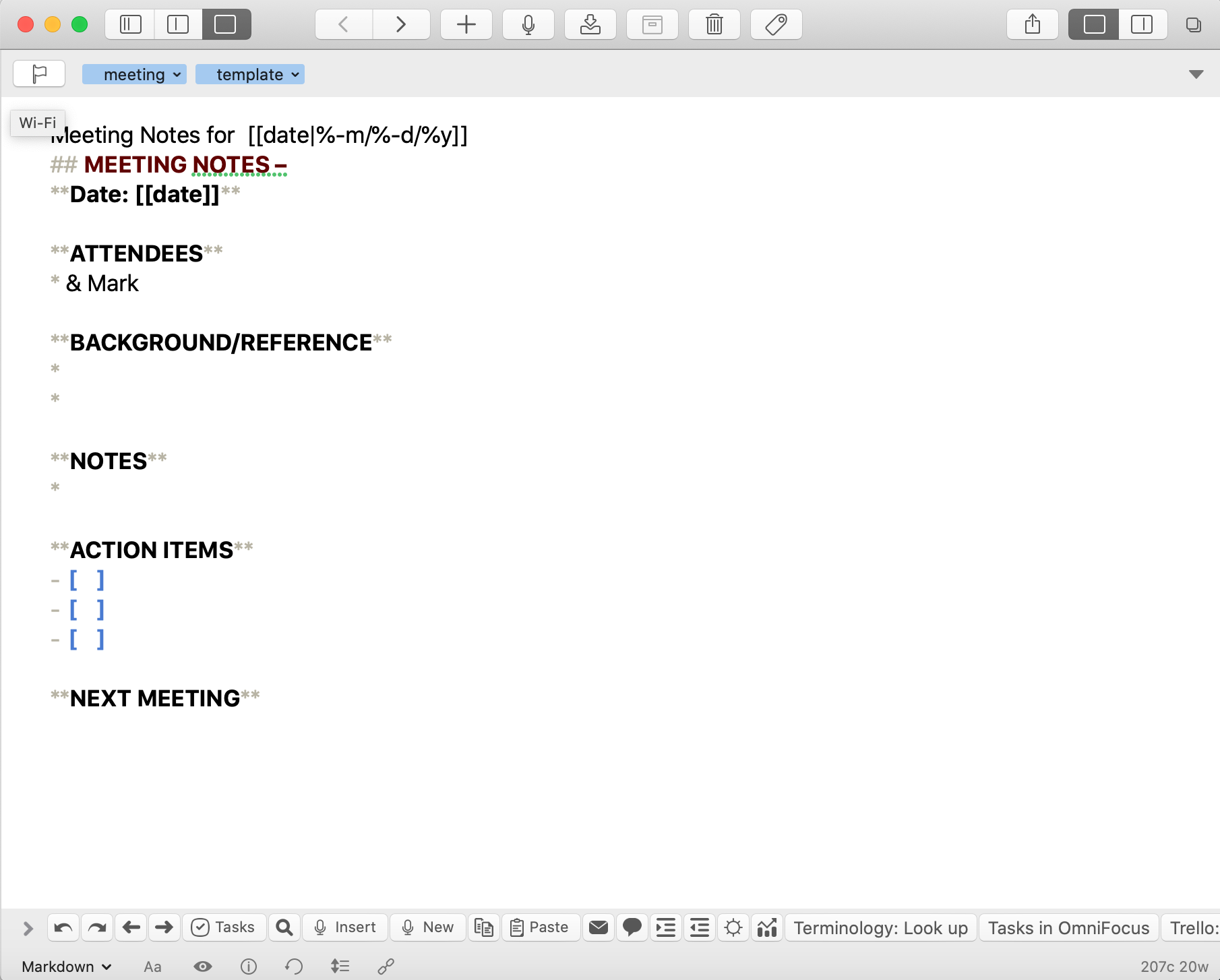

Thank you for your help. I have set up several templates following the instructions from the post that @agiletortoise pointed out. That specific post was the tutorial that got me started. I am a real novice when it comes to adding more features and complexity. However, I would like to get better at using Drafts and automating as much as possible this year. I had used TextExpander for years but decided to use a Drafts template over the last couple of years. It has been great for productivity and professional enhancement of my work.
My main goal at this point is to pull a blank template quickly using IOS shortcuts. If I had access to this template on the fly, I would be able to do a better job of paying attention to my client in those moments where I am facilitating a meeting, trying to be engaged, and also find myself the only one taking notes. It happens a lot, and fumbling around and trying to multi-task is not ideal.
My template is rather simple, as you can see at this point.
I want to add more features and refine further and learn how to populate with calendar information and answer questions but to start with quickly pull up the template.
