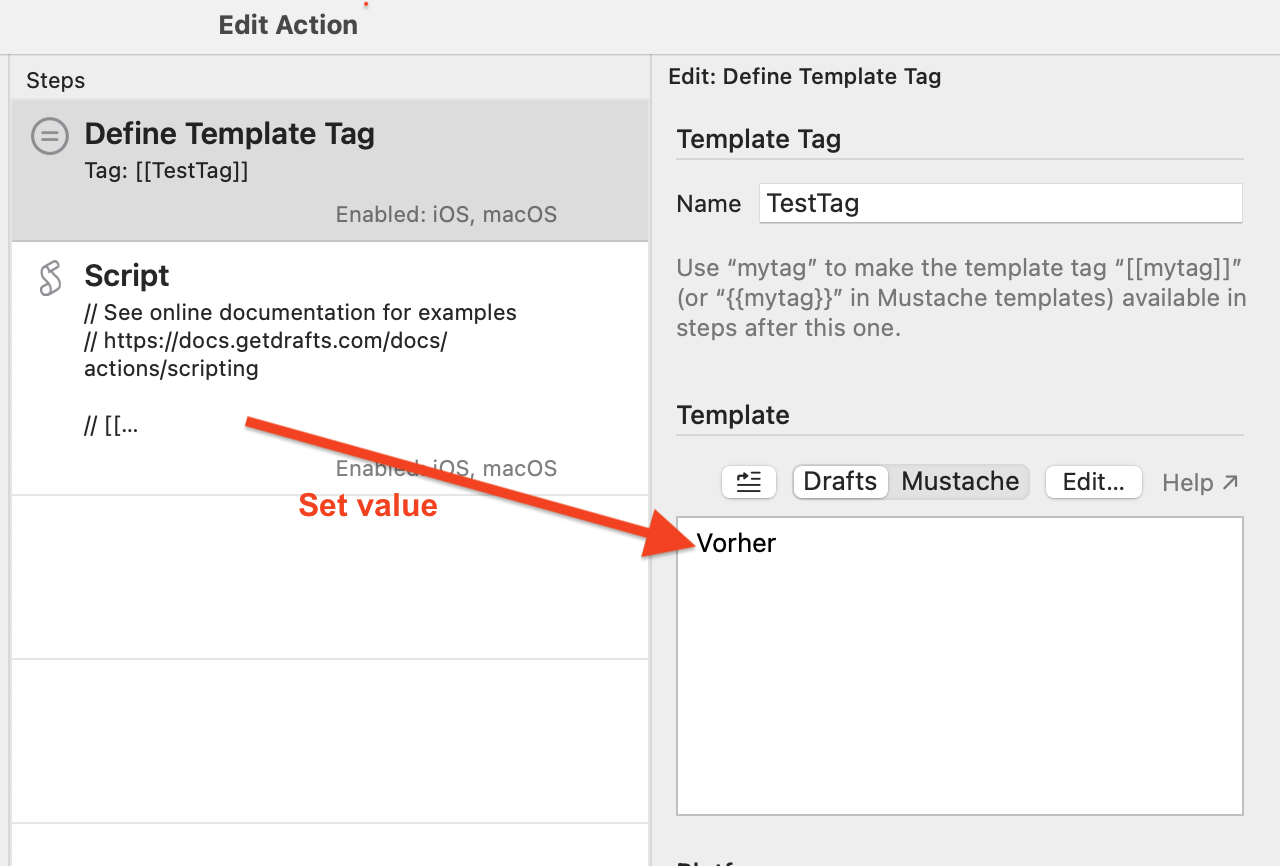

There is an Action Step to define a Template Tag (name and a value).
In a script draft.setTemplateTag defines a new Template Tag (name and value).
Would it be possible that setTemplateTag can not only be used to define a new Template Tag but also to change the value of an existing Template Tag which has been created in an Action Step? Meaning the value of the Template Tag in the Action Step would get changed. (Since this would affect the action maybe action.setTemplateTag would be more appropriate than draft.….)
It would be working similarly to app.getClipboard and app.setClipboard.
My use case: I have a list of static buttons and I would like to have an additional dynamic one called “Last used”. By changing the value in the Action Step “Last Used” would be valid no matter when this action was used again.

My specific use case: The action contains of a list of Bookends references like {Kaufman, 2021, #297372}. The list is stored (and maintained) in a Define Template Tag. It holds a number of these references, divided by pipes.
When I launch the action the script creates buttons for each reference to pick from (and it does more, which is of no relevance here though). I would like the action not just to process the chosen reference (like inserting it into the present draft) but also to set [[LastUsed]] to the chosen reference. But [[LastUsed]] would not be a Template Tag defined inside of the script but defined in an Action Step. And the script would change the value in the Action Step.
