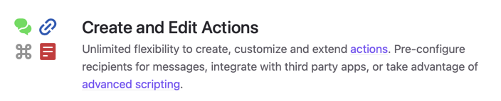

I think, actions, require the paid version, right?
If so, then maybe I need to go ahead and subscribe.
It is worth subscribing in my opinion, but no, actions are free to use and run. It is if you wish to create and edit them, that a subscription is required.
Even with the free version you can download and use the action I posted above. What you would not have been able to do is the modification I did to the original Save As action to make it work like this; unless you got a subscription.
