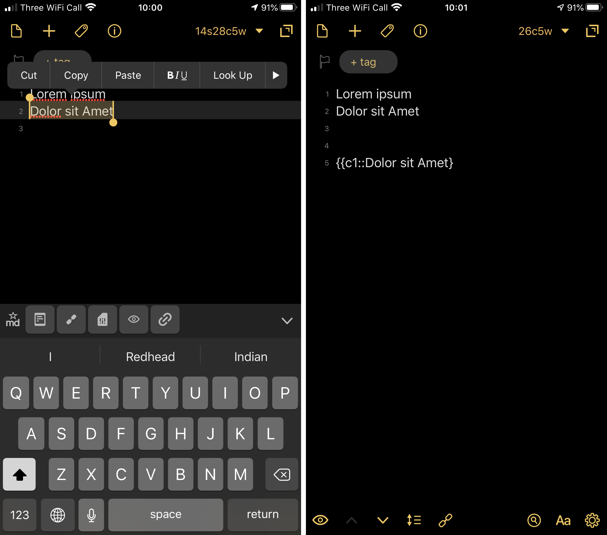

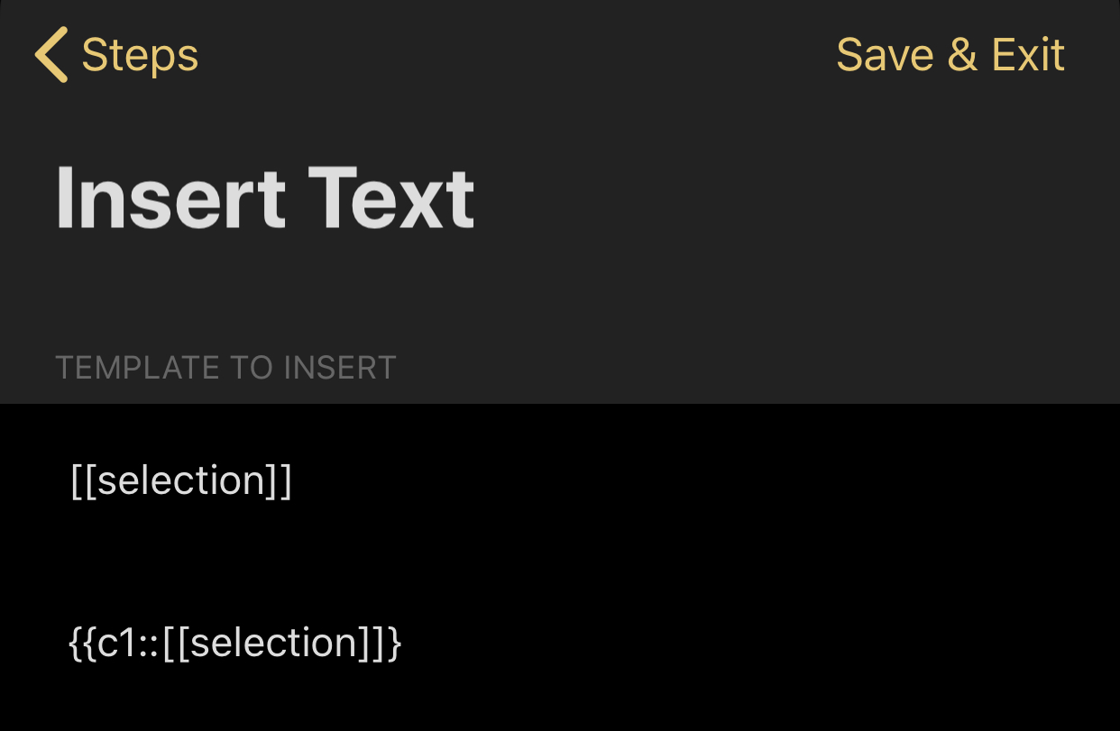

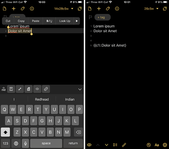

I’m not sure I quite followed that, but here’s my first guess at something that might help.
This action takes the currently selected text and replaces it with the currently selected text, followed by three new lines, followed by the selection wrapped in the format you showed above.
The action does not require the use of the clipboard, and so should have fewer steps; but still match the result I think you have described. It consists of a single insert text action step.
The screenshots below show what happens when run against a selection.
If the content was in amongst other text, this probably would not work as desired, but the principle remains and you could then tailor the insertion content and utilise the [[clipboard]] instead of [[selection]].
Thanks so much I was able to modify and it works like a charm now. I need to learn how to post to the forum for other possible members to benefit from it.

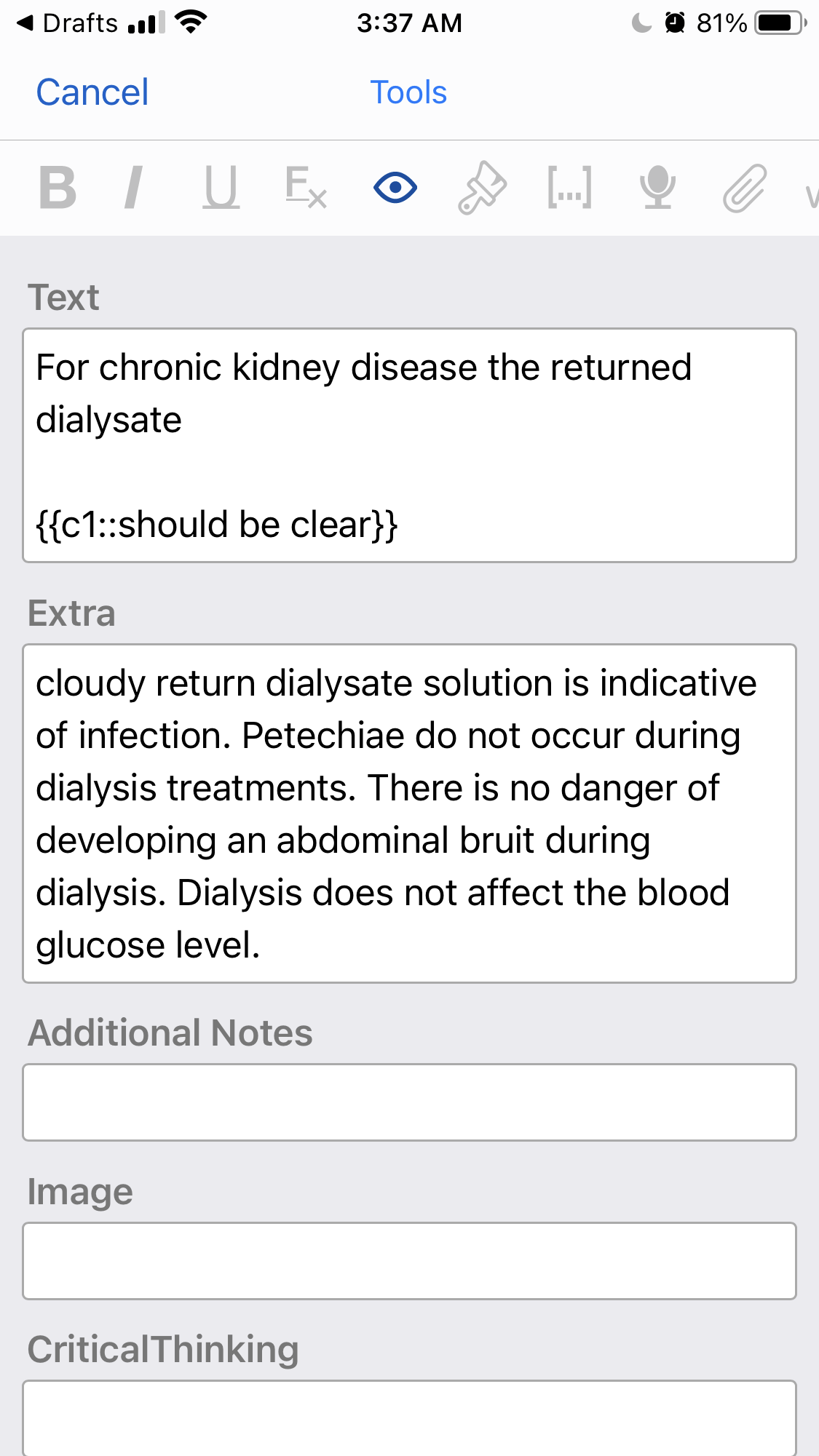

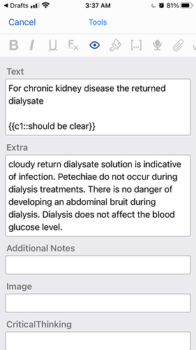

Thanks so much it worked like a charm !!! I will have to check tomorrow morning if it will work from the desktop version of Drafts 5 as well but on iOS it’s amazing.

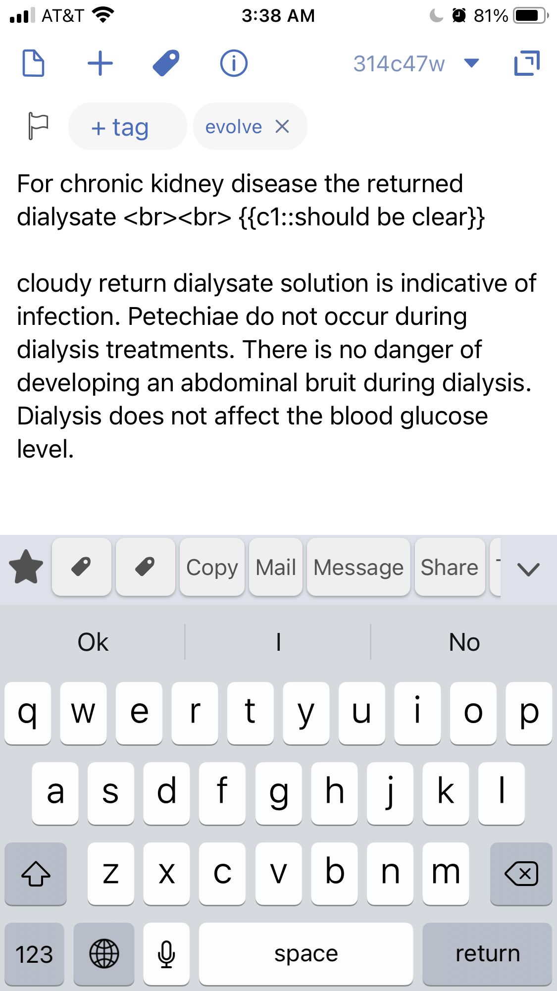

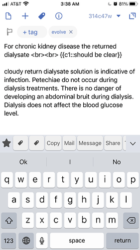

Here’s my action:
anki://x-callback-url/addnote?profile=User%201&type=JL%20Cloze%202.0&deck=Default&fldText=[[title]]&fldExtra=[[body]]
I might try to add Tags as well. In my case it will be same Tag.
Triple thanks for all your help. Here’s the visual part which may help some folks too. Notice how I added to the title the space HTML code because the it wouldn’t pass in the url saved in the action. I like my close returns ANKI to look like this.
