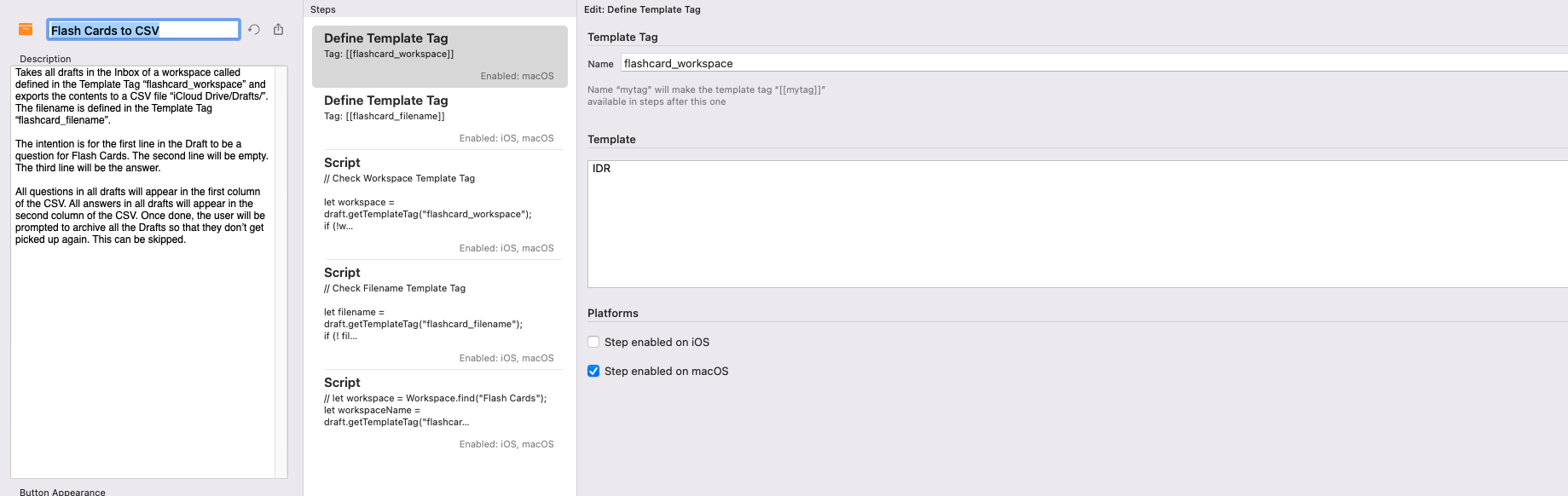

So I tried and followed your instructions and here are the results.
I first setup the following as instructed.
and here’s the other template tag
Here’s the workspace
and I get this
So I’m not sure what it asking in the error message.
The first action step defines the variable workspace.
let workspace = draft.getTemplateTag("flashcard_workspace");
The third action step then attempts to redefine it.
let workspace = Workspace.find(workspaceName);
That’s not allowed, and that’s let doing its job of not allowing it within the same scope - they are both defined at the top level of the script and so apply across the whole script.
Those two variables, and their subsequent use, need to use unique variable names.
I thought I had fixed that before publishing. I will fix later today. Thanks @sylumer for catching
