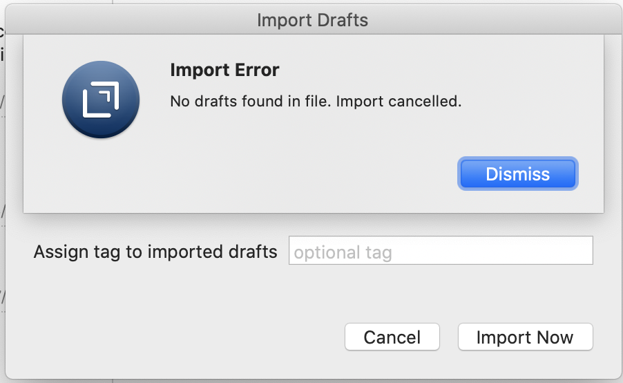

thanks! I’ve actually got a small python app that will create my JSON from a directory of .md files. However, when I try and import a test note, I get the following message:
Here’s the JSON I’m trying to import:

Any ideas on what I’m missing?
Looks pretty close. You need a tags: [ ] key, even if not assigning tags and the dates should be valid ISO 8601 dates, which need a time zone specifier…which means just add a Z at the end if your dates are already UTC dates.
[Update: Also, the long/lat should be numbers, not strings. Do not wrap them in quotes]
If this is the last entry the extra comma between the closing braces might be the problem

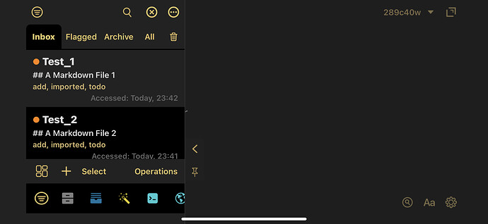

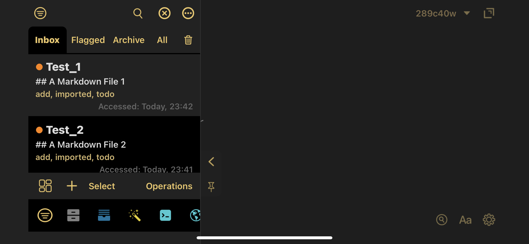

Hi @gcaprio, I am missing something in the import step in drafts. Neither the ‘Import …’ menu nor the Drafts/Inbox folder seems to work.
it only imports my json and does not create to drafts.
how did you do it?
@gcaprio found it …
The Date is not right yet, but that should not be so hard to fix
oh awesome. did you figure out the date issue?
did not look into it yet.
I guess a string formatting or time zone thing
The dates should be iSO 8601 format to get parsed properly.
Yep. ISO 8601 has two possible ways to define the time zone. Python picks the other than drafts. A simple replace fixes this. Now it works. Thanks Greg.
