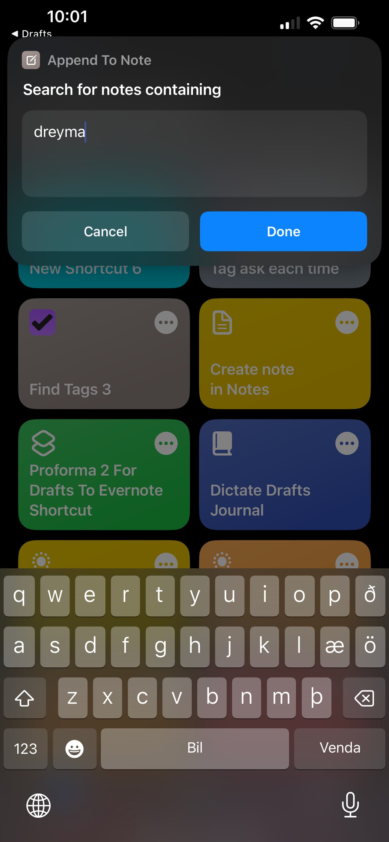

I forgot to say the way I an currenntly appendind from drafts to an apple note ( I search for) is through Siri Shortcuts which is ran within drafts, a draft forum member recomended the shortcut.
Im basicly wondering if this eas possible

I am mostly searching for to be able to do this with evernote and/or Notion like Im able to do eith apple note.
(see pictures)
You cannot do that in Drafts. I do not know about what the apps from those other services offer in the way of Shortcuts support. I’m guessing most would not support that level of integration.
If you have shortcuts to append to specific notes in Evernote / Notion and so on then I suggest you modify them to accept text input (in addition to the prompt) and then run the shortcuts from Drafts.

Now this apple note “append to note” action is giving me problem, is anyone else experiencing this ?
After
-searching and selectig the correct note
That looks like the Shortcuts bug that’s supposed to be fixed in the next OS release. An action isn’t using the input correctly and offers a selection.
