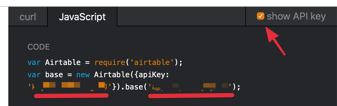

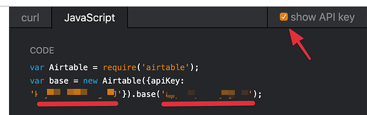

  • Go to your Airtable database, and click “Help > API Documentation”
  • In the API explorer, click the “Javascript” tab and “show API Key” option (see below).
  • Make note of your base ID and API key in the example code.
  • Edit the action in Drafts, and change the “Define Template Tag” steps for the airtableAPIKey and airtableBase to match these.
  • Edit the airtableTable define template tag step to match the name of one of your tables.
  • Edit the airtableFields define template tag step to be a comma-separate list of actual fields in your Airtable table.
