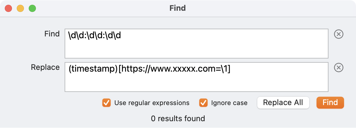

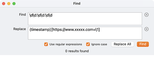

The way you would do that with find and replace would require regular expressions. This example shows what that would look like on the Mac:
(You can do the same on iOS, just need to use “Advanced Find” which you can get to by tapping and holding on the magnifying glass at the top.)
The \d\d:\d\d:\d\d is a regular expression that says to look for three sets of two digits, separated by colons.
The replace value has the \1 to indicate where to insert the value found in a new string.
it seems not working, do I need some special settings?
the result for me is ‘(timestamp) [https://www.xxxxx.com=1]’, the original timestamp was replaced by ‘1’.

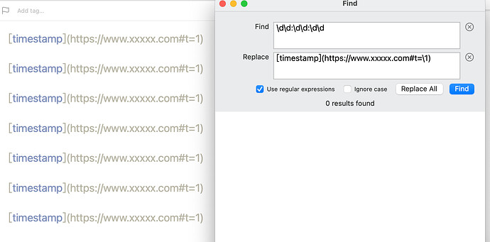

After changing to ‘$1’, still weird, original timestamps are still replaced.
This is what I want:
‘00:23:30’ => ‘[timestamp] (https://www.xxxxx.com#t=00:23:30)’

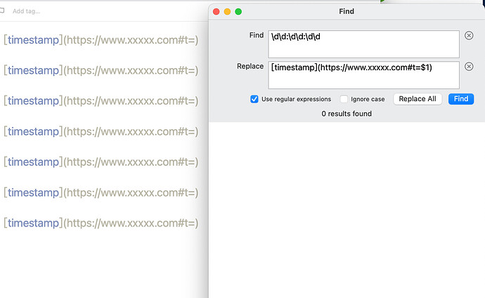

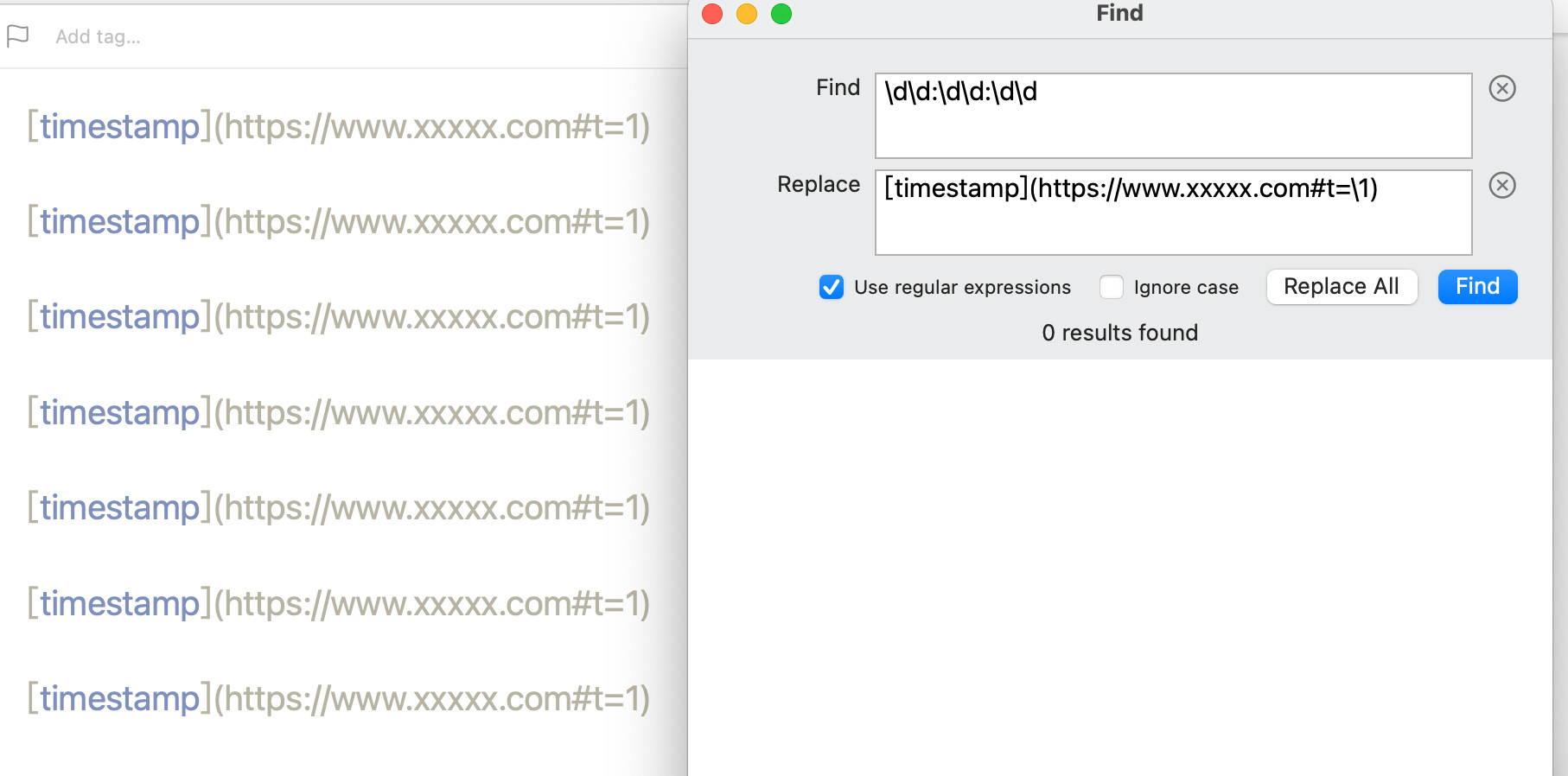

using ‘/1’, the result is ‘[timestamp] (https://www.xxxxx.com#t=1)’

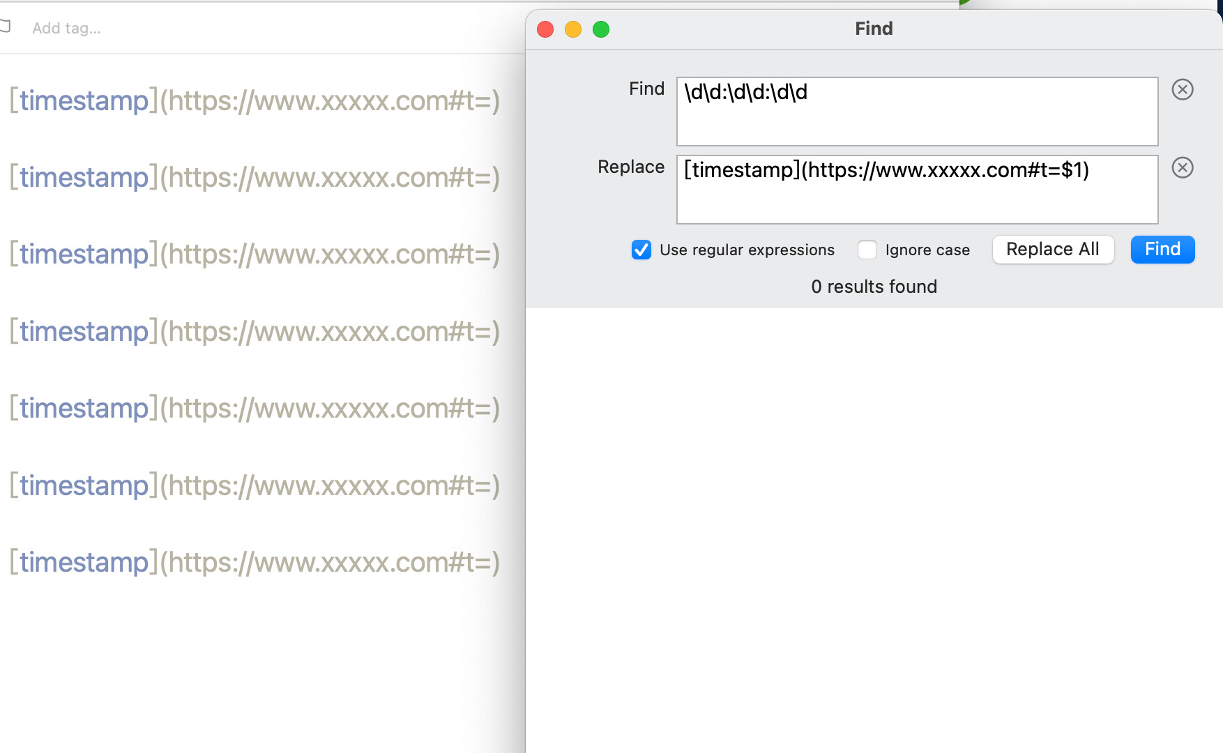

using ‘$1’, the result is ‘[timestamp] (https://www.xxxxx.com#t=)’

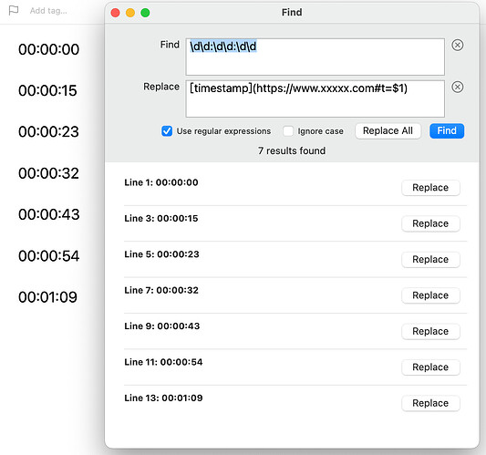

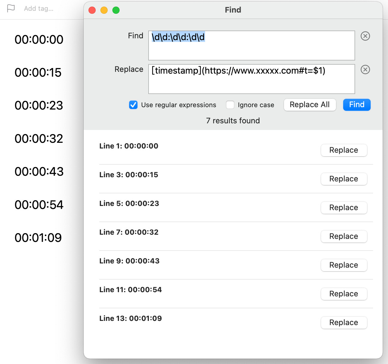

I’m not in a position to do much testing on this just this moment, but off the top of my head I would try the following replace with the “Use regular expressions” option enabled.
In the find:
\d\d:\d\d:\d\d
In the replace:
[timestamp](https://www.xxxxx.com#t=$1)
Take a backup, give it a try and let us know if that works for you.
the original timestamps are still replaced.

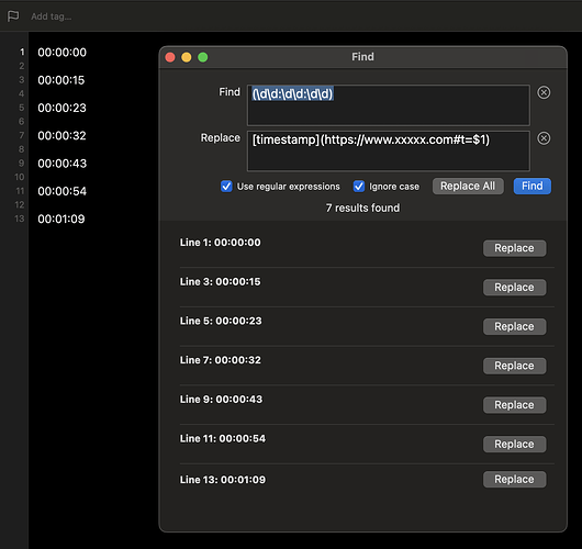

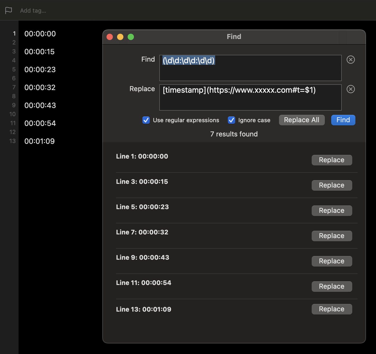

Change the find to:
(\d\d:\d\d:\d\d)
I wasn’t at my Mac and I figured it was an implicit match group … but it wasn’t. The parentheses in the find define the match group.
Before replace all

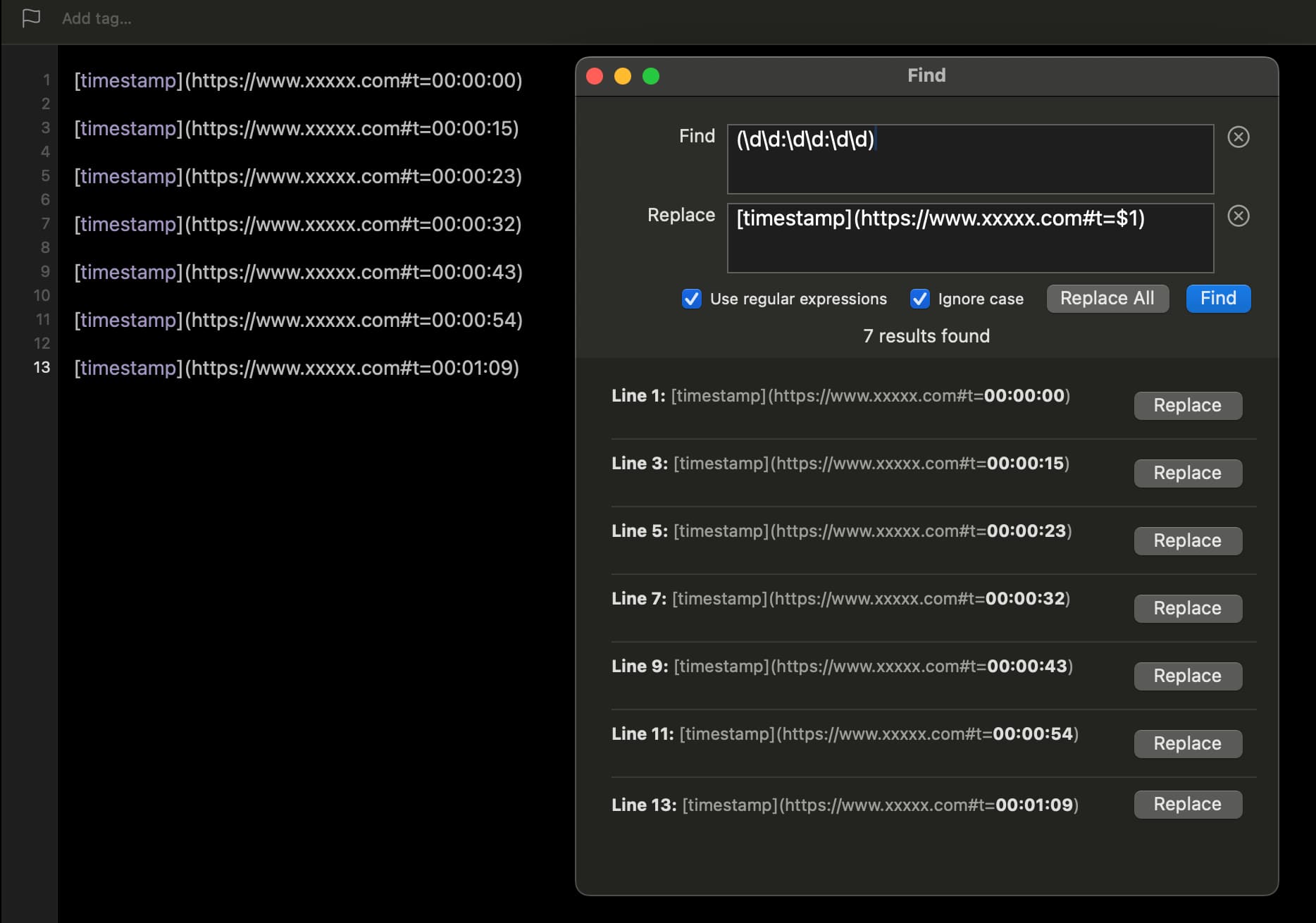

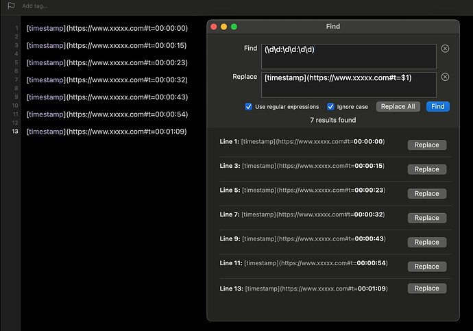

After replace all
Thanks. It’s working. What magic round brackets!
