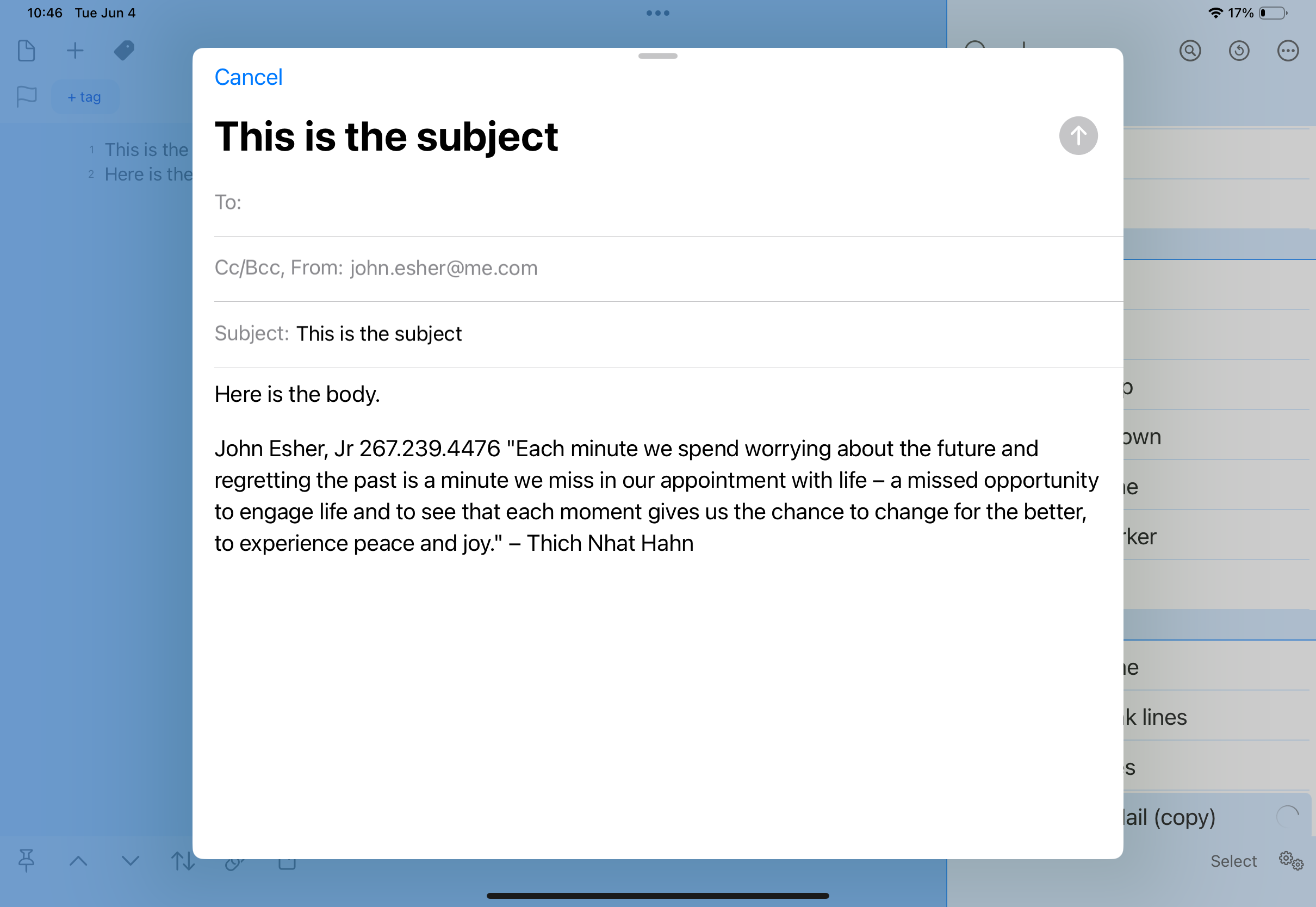

I was able to find the UUID of the draft containing the hundreds of quotes. I was able to figure out that I needed to add the script action prior the mail action and did so.
Now I’m just stuck on a formatting issue – the [[quote]] tag is after my contact information on what I thought would be a new line, but it seems to be disregarding the “return” key. EDIT: I just noticed that it seems to skipping the returns between my name and phone number too.
Any tips?

The body you have specified is your mail action is this.
%%[[body]]%%
John Esher, Jr.
(267) 239-4476
[[quote]]
The mail action also has this option set.
2024-06-04-20.25.45
So you need to define everything in HTML for your e-mail.
The %%[[body]]%% takes the body of the draft and the four percentage symbols indicate that the body tag content should be interpreted as Markdown and converted to HTML.
The remaining content isn’t defined as or converted into HTML, so it just gets output as one long string of text.
The quotation tag can make use of the same quadruple percentage symbols to convert that into HTML.
The name and number are not in a tag, so for that, the easiest thing is to pop the HTML in directly. We can wrap them in a paragraph block and put a line break tag in to force the line break.
Try substituting in the following for the mail action body.
%%[[body]]%%
<p>
John Esher, Jr.<br>
(267) 239-4476
</p>
%%[[quote]]%%
Thanks for the lesson and the solution, it works perfectly!
