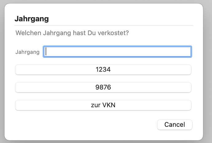

I revised the whole thing and now I stuck again. I created a promt with some buttons created from the content of a existing draft and a textField. It looks like this:
The last button („zur VKN“) takes the textField entry.
My question: How can I change the order of the buttons? In the script I create the buttons with numbers first, then the textField, then the „zur VKN“ button. Anyway, it is displayed as shown. Can I somehow change that? As it is now, it is not very clear that the last button belongs to the textField…

Buttons are always grouped as the last elements in a prompt. Probably the best option for visual separation is to make it the default button, which will pin it with the cancel button, and make it the button that responds to the default (⌘-return) keyboard shortcut. Like:
p.addButton("zur VKN", null, true)
If you find the standard prompt options too limiting, you always have the option of builing an HTML-based prompt using the Advanced HTML Previews functionality.
It takes more effort than the standard prompt, but you can lay things out however you want.
There’s an example action in the documentation above that you could use as your starting point.
