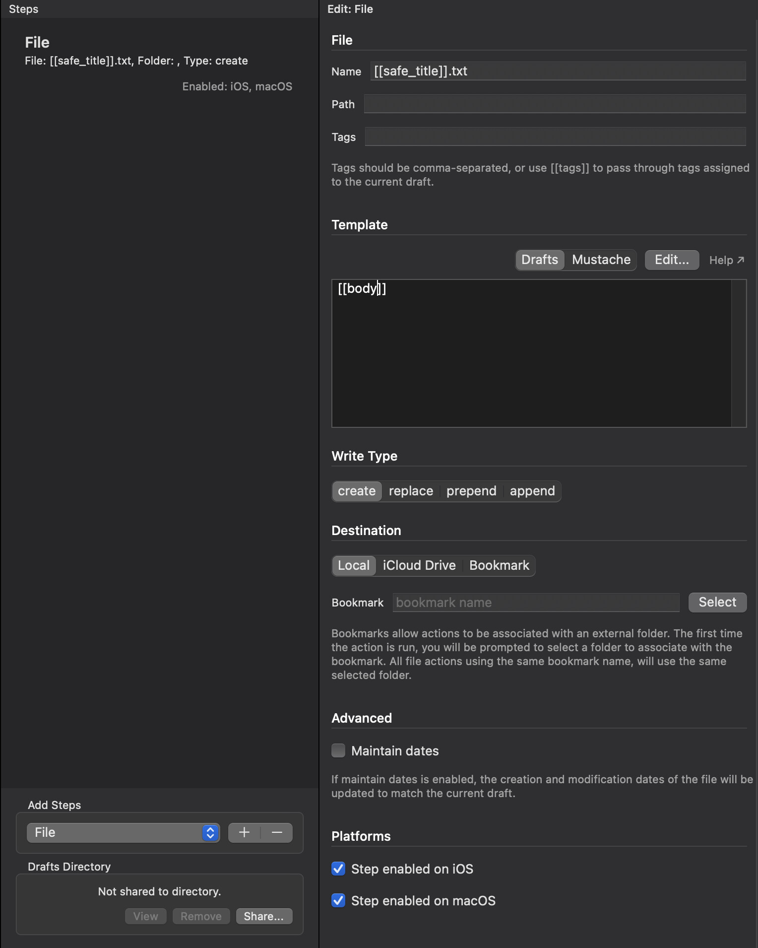

You can do that without any JavaScript - just using the file action and Drafts template tags.
You can set the file extension of .txt to .md, etc. as you require.
You can use those tags in JavaScript too should you actually want to do more complex processing and saving within a script step:
