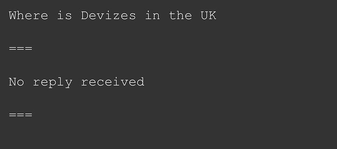

I am now getting this result when I run the action ( version 3 I think) (now version 4?) on Drafts iOS but if use the same query directly on the ChatGTP app I get a normal response. I’ve tried adding the action again but no change. I am still using the free ChatGTP subscription. Any suggestions?
Thanks, Dale
As mentioned in the article at the top of this thread, you are not likely to get far with the “free” plan and API usage. You will need to setup billing at OpenAI.

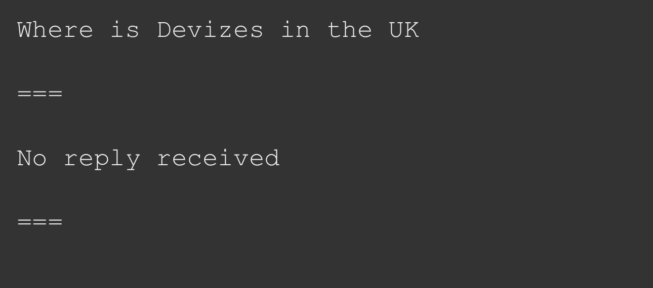

So I’m using Ask ChatGPT. API Key successfully added but after writing a prompt I keep getting:
Any ideas as to what I’m doing wrong?
Thanks.
Is there additional detail on the error you are receiving in the Action Log?
