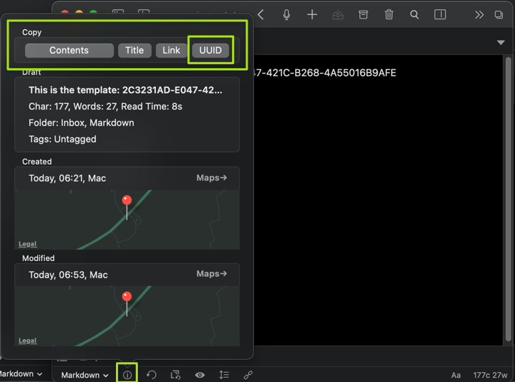

At the top of my template, you’ll see it has a random looking string. This is the unique identifier of the draft (you can copy it in the info section of any draft), and is shown here just for illustrative purposes. The key parts really are the inclusion of those substitution tags.

The function takes a single parameter. The UUID of the template draft, the one I showed in the template so you could see how it is used later … here. Therefore for the example template, my function call looks like this:
constructDaily("2C3231AD-E047-421C-B268-4A55016B9AFE");
Putting the function and the function call together in an action is just a case of adding them sequentially into a single script step within an action.
To use this, you just need to edit the action and set that UUID to the UUID of your template draft. The function call line is the last line of the action step.
